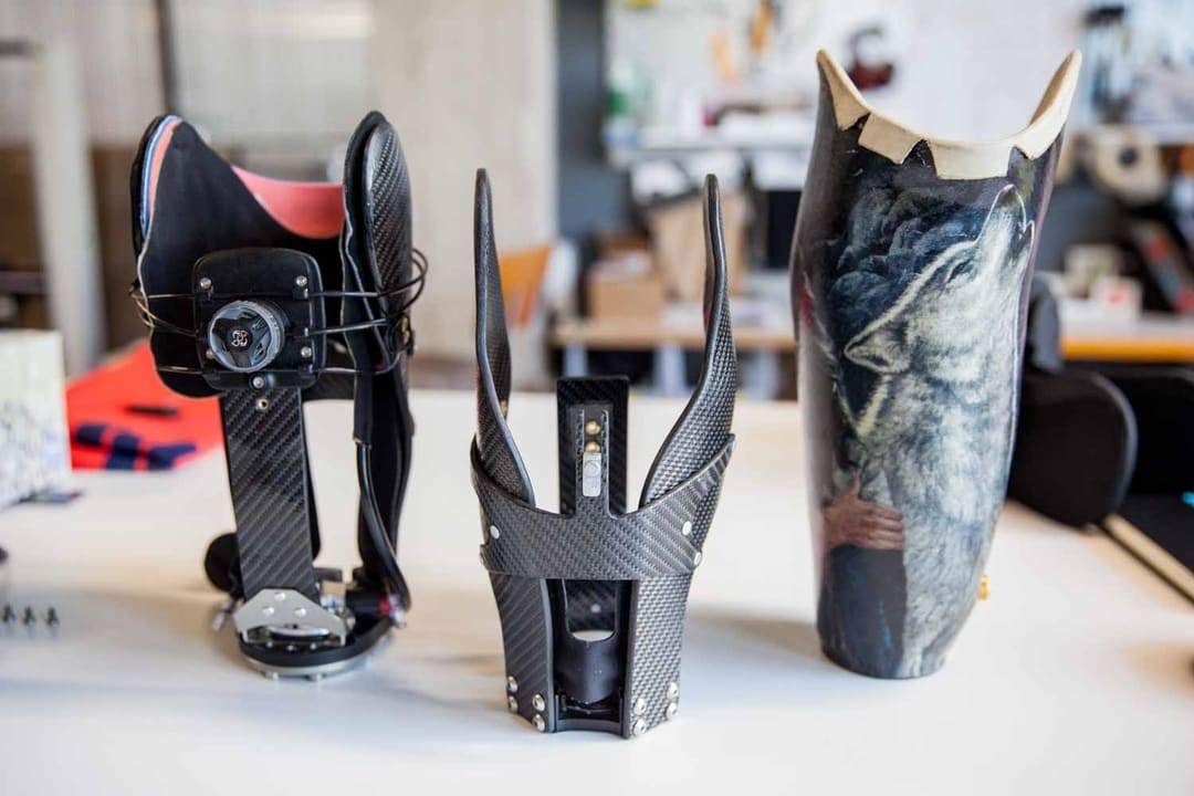

Hundreds of quality parts for prosthetic devices icon
